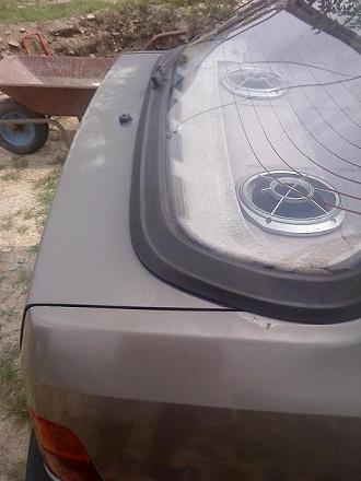

Hi,just 1 quicky:
how can i remove the rear tapisery,you know that small,right under the rear glass,U-shaped.cuz its in bad shape.
i can see it has 2 plastic things-(dont know how to label it).
thanks.
(i told you ill have question) ::d

Yes, it has two plastic clips. You just need to remove them I guess.

yes,2 plastic clips,i thought maybe it has something more,i will try to take it down today,later ill post some pics of the legend :)

I think it has more than two clips... Try to touch from the inside of the boot.

You need to remove those 5 ornaments, from the vent holes. Apart from the plastic clips, they hold it in place. But be careful because the plastic is easy to break.

this is the rear tapistry,the one holding to the back door,yes,there were 2 round plastic clips and also those 5,which began to snap fast so i gave up,simply,too easy they snap.

These vents holding the carpet are just shxx!! You can only remove them once because they break in your hands.

i know, they broke when I got mine off. No they don't hold the carpet anymore, I had to glue it in place

yes,i was really carefull and still they,broke imidiatly.
but ok,they spent entire time directly under the glass on the sun,its plastic,it was bound to happend.
